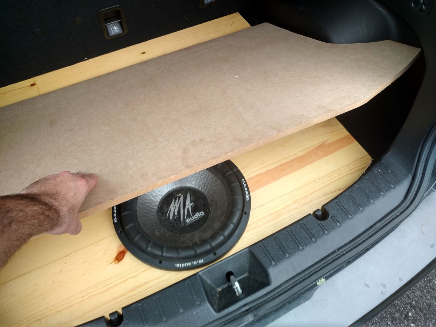

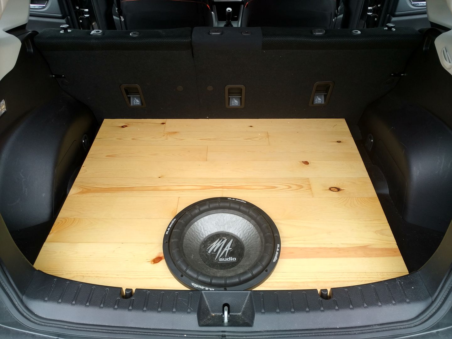

Not really an off-road mod, but something I have been wanting to do for a while...

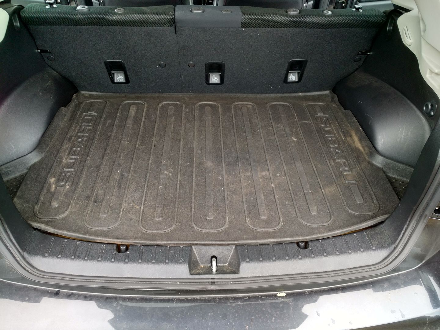

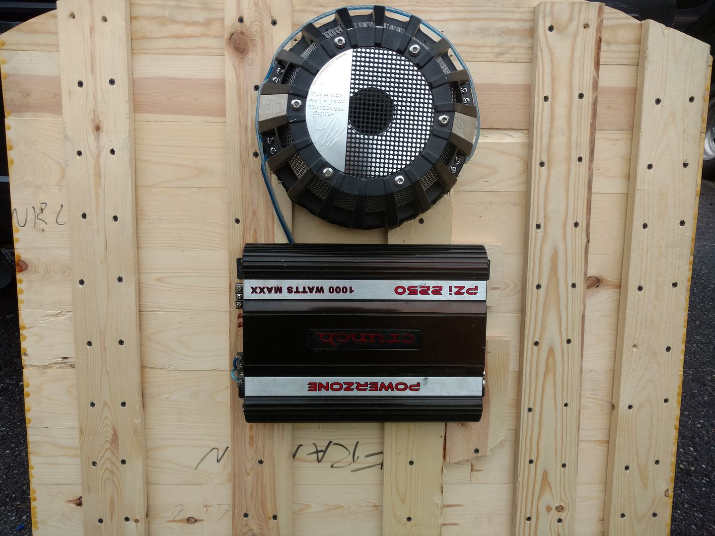

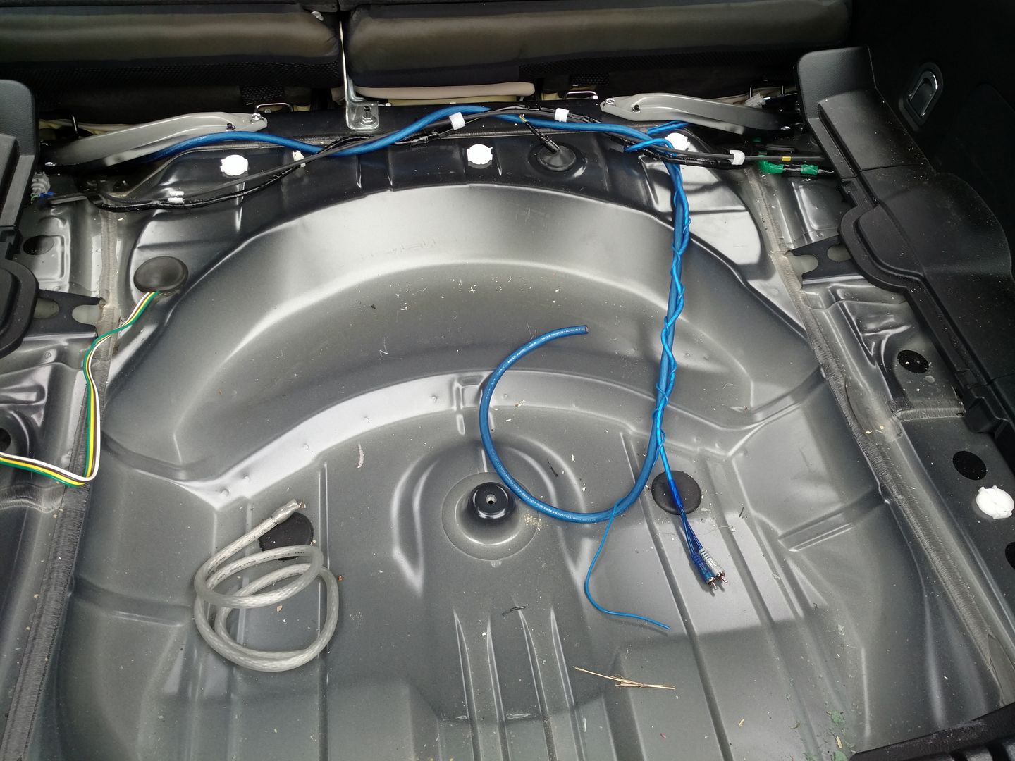

Spare tire is useless since I have the larger mud terrain tires, so I asked myself "how could I better use that space?"

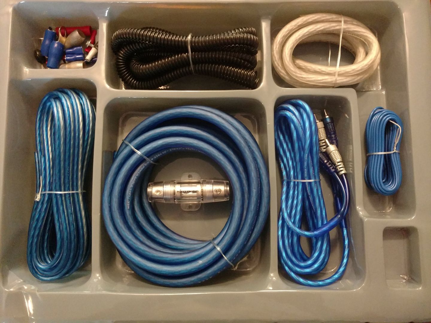

I had to build a platform to raise the sub off the floor as the spare tire compartment is shallower than I expected. I then built a raised platform over the sub so I could still use my cargo area without crushing the speaker. The sub and amp I got for free from a friend when we upgraded the subs in his truck. The wood was free scraps from old projects. The wiring kit I purchased off eBay for $24. The six-pack of beer was $9... So, three hours, $33 and a little buzzed later, it is all set except the Line Out Converter which I was a little too "relaxed" to remove the head unit without risking damage.
What do you guys think?
That new spare tire looks tiny... j/k
Nice work! Not sure how strong that sub is, but you could always add some foam around the edge of the wood if it ends up rattling ilke crazy against the metal in the trunk. It might not need any, but the foam might also help the sub perform better having a "sealed" enclosure. I dunno though...

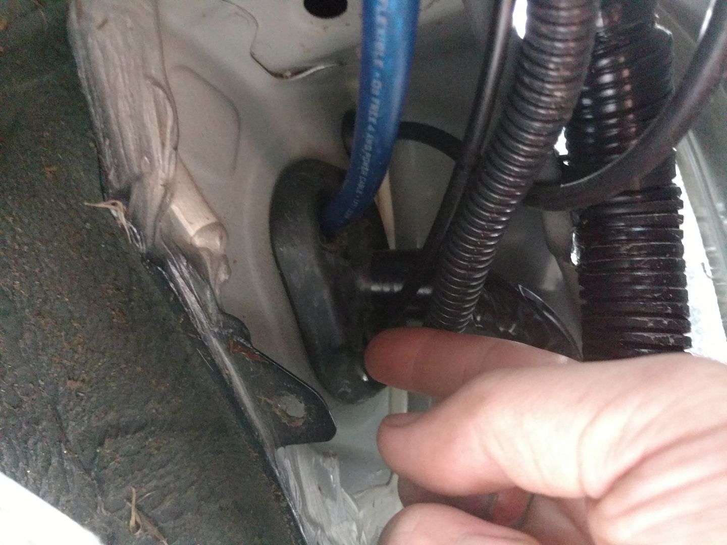

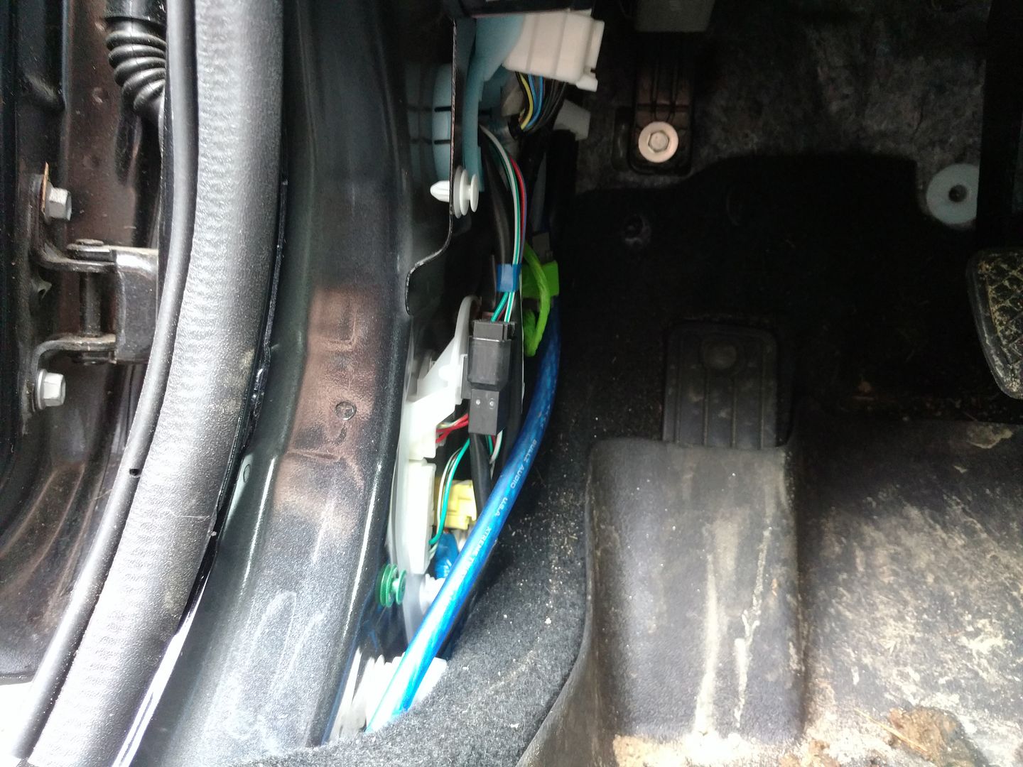

Where did you go through the firewall?

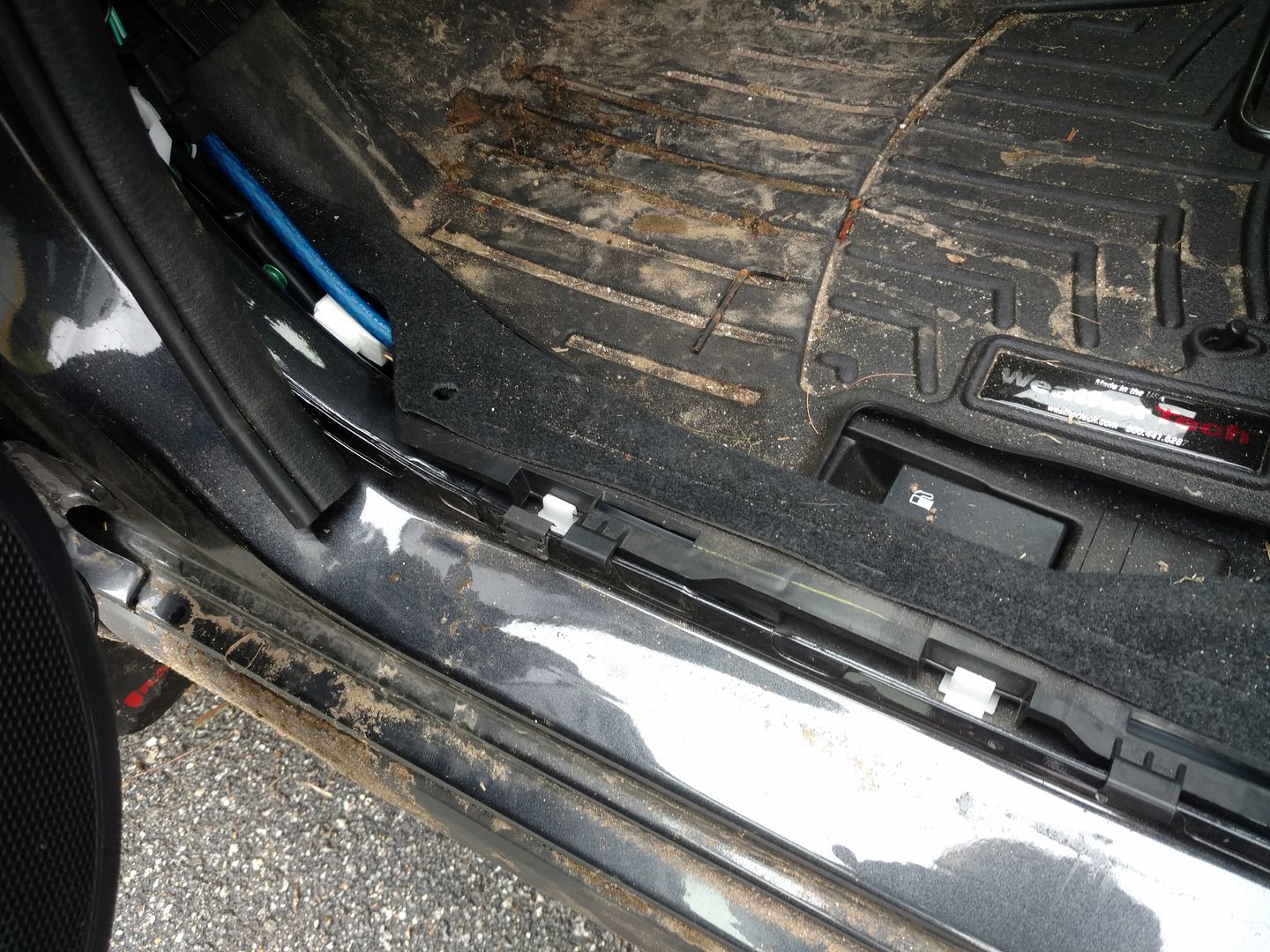

If you pull the left front wheel splash guard. Behind the fender is a large rubber grommet. It is about here:
It is actually really easy to reach:
I made a tiny hole with a pick (being sure not to damage any of the wires in the area) and forced the amp wire through. The grommet made a great seal around the wire.

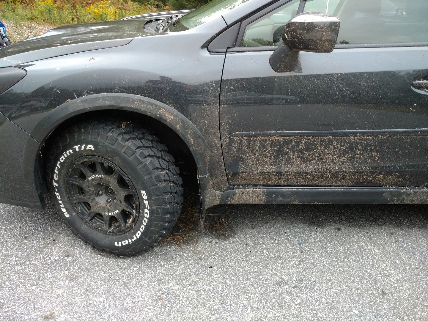

Muddin'? That looks to clean to be muddin' lol! Now this is getting mud on a Subaru!
Discussion starter · #56 ·

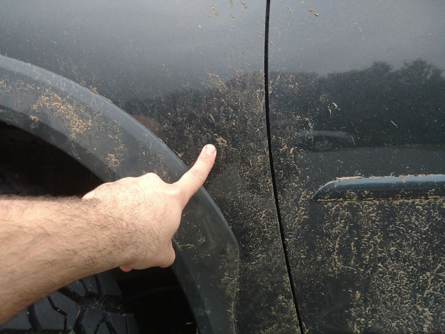

We've been in a drought out this way... Today was the first rain in weeks so I hit the biggest mud hole I could find (about 20 feet long, 8 feet wide and maybe, just maybe 7 inches deep) I tried so hard to wallow like a pig but there's only so much a man can do when mother nature tries to stop you.
