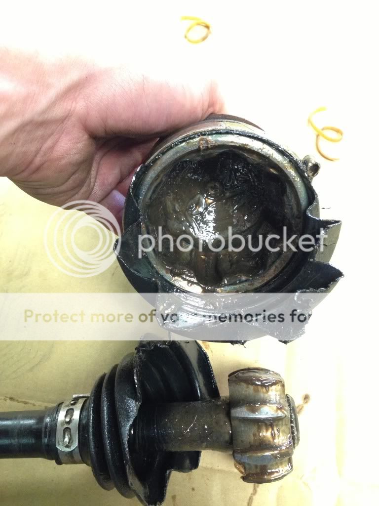

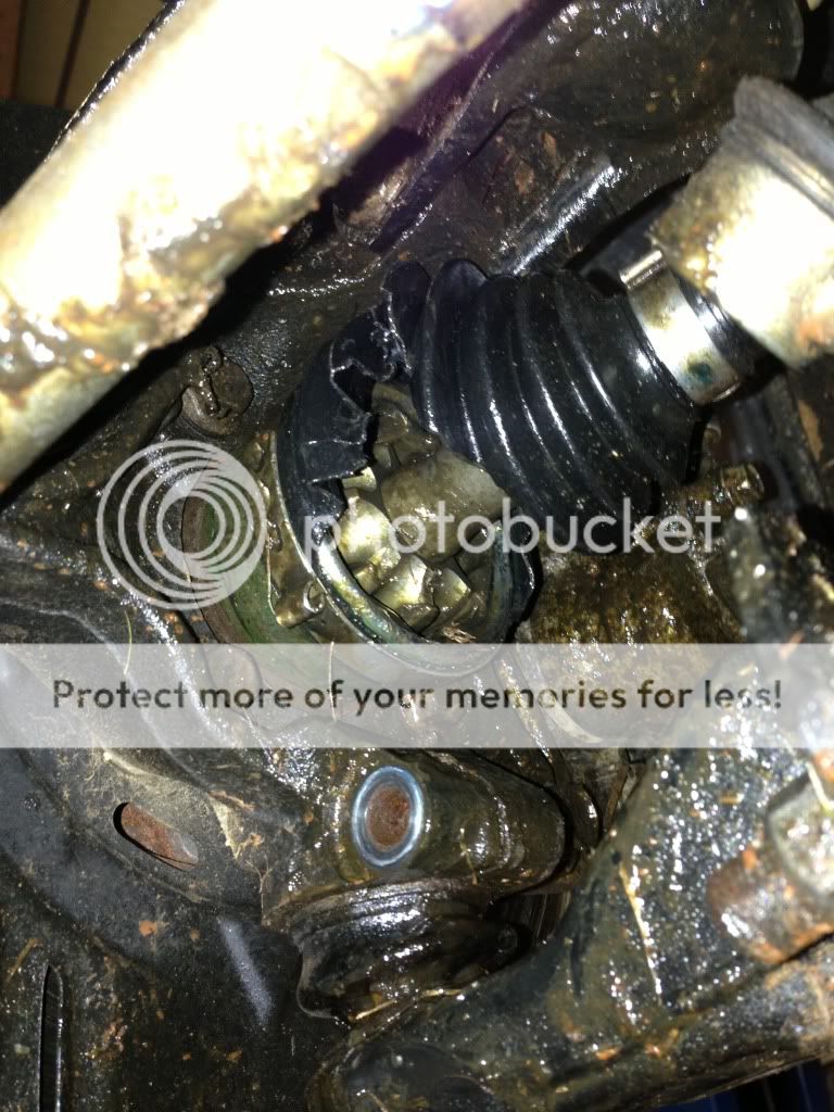

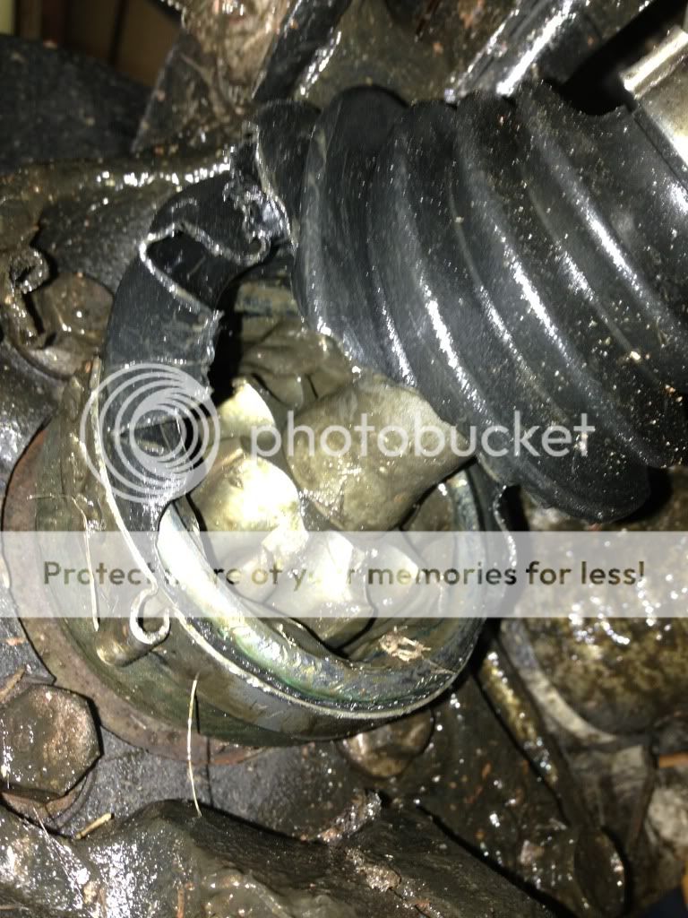

I was having some fun driving around on some nice smooth wet grass. The wheel was turned full lock to the right and my car was going completely sideways. I hit the brake just to see what the vehicle would do and *SNAP*! Front right CV Joint completely exploded. My thought is that with the wheel spinning fast the abrupt braking put to much stress on it due to the wheel being completely turned.
The first dealership I called told me they haven't heard of anything thing like that I was full of ****. Basically talking down to me so I called another dealer twice as far away. When I took it to the dealership and TOLD THEM "hey the axle is broken. I was spinning on the grass with the wheels full lock right and the CV joint snapped". I figured it would be covered under warranty. Long story short a subaru rep had to come down to the dealership, took a look at the car, and denied the claim. They made every excuse they could saying grass and mud was all under the car and I have skid plates and "rally lights". I told them I was off road... They said the vehicle was pushed beyond its mechanical limits.
Picked up the car, bought a brand new OEM axle from subarupartdepot.com, and put in on myself at my dads shop. Took less than an hour to do the job and I bought the part for $370 shipped. Subaru wanted to charge me over $700 for the part and labor.

Hey Brian... your "broke" pics made my stomach upset, I had to go take Tums. Be sure to post us some photos of her all clean and fixed up!

I just realized this but if your axle snapped and the stub came out, your wheel bearing may have been damaged. I'm not sure about the specific configuration of the xv but for most subarus, the manuals tell you to torque the axle nut before putting the wheel on and down on the ground. Use the brake to keep the hub from spinning rather than torqueing the nut on the ground.
If the configuration is similar to other subarus there was nothing holding the two inner races of the bearing together while the shaft was broken, except for the press fit between the hub and the inner inner race.
this would make sense with your description of having to hammer the shaft back in to get the wheel to straighten out.

I'll add my .02.. The only way that axle broke is if there was a defect. On a slick surface of any kind, traction control or not, there is not enough torque being put through the axle to break it. Even at full lock there is not enough pressure being put through the shaft on the XV. That particular activity could not have broken the axle unless it was already cracked, or somehow damaged or defective. Even if you were to spin the wheel way up and then slam on the brakes, there is not enough inertia to overcome the amount of torque that axle can withstand.
I do have a question though, was the boot torn before this happened possibly? If dirt and or rocks got into the CV joint, that "could" cause this kind of failure. Another thing that could cause it is if the chassis/rack and pinion allowed the wheel to travel past the limits of the joint at full lock. But, it would have to allow a whole lot of flex for that to happen.
Were the races nicked up? What kind of shape were the balls in?
