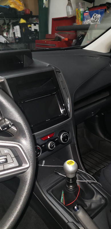

After installing the Rockford Upgrade I was disappointed with the I did way the HU was acting. I did a bit of research and decided to ditch the stock HU off of my Base 6MT. I figured since I do not have any telematics, it should be fairly straight forward.
I ended up following the install guides on the Impreza5 forums (thanks to Robzz's guides) since the wirings are very similar/identical. Was fairly straight forward. The only curve ball was a "backup module" that is mounted directly over the stock HU. That module controls the doorlocks which took a while to figure out until I had to get the wiring diagram for this car, haha.
All wires were soldered, shrink sleeved, and laced with lacing tape.
I will eventually reroute the Pioneer microphone to the Stock mic location.
Bought:
1. Pioneer AVH-2550NEX HU
2. Subaru Rockford Fosgate Upgrade
3. Fosgate 6.5 R165X3 for the rear speakers
4. Metra 40-LX11 Antenna Adapter
5. Metra 70-1761 Speaker Harness
6. Metra 95-8908HG dash kit
7. Metra AX-SUBUSB2 USB Adapter
8. Axxess AX-SUB28SWC-6V Harness
9. Axxess ASWC-1 Steering Wheel Control Adapter (FAIL)
10. Maestro SW Steering Wheel Controller
Testing the Maestro
The backup module is all zip tied and sandwiched under the upper dash. I had to open it up and dremel the supporting housing (to the stock HU). I may machine a mounting bracket in the near future. For now, the zip ties should hold.;)
All buttoned up
Issues
The Axxess didnt seem to work on my end after a long time debugging everything, so I ditched it for the Maestro SW. The Maestro SW (2019 Impreza Firmware) does work for the most part except that the "Call" and Hang up" buttons are not responding. Has anyone had issues with this?

So, I have a base 6 MT model also and what I listed is what the head unit controls. I’ve only read about people that have done it themselves rather than get it professionally done. However, I haven’t found/read anyone who can confirm what happens to the control features.
The wiring for the steering wheel controls (Volume up, down, seek, source, call on/call off) are controlled by the headunit with 3 wires. The other buttons (info, cruise controls) are on another circuit so its unaffected. Clock adjustment, interior lights, defogger, lane changer are also on a different circuit. Same with the A/C and everything else are on a different circuit (for the Base). I did test everything and it still works ;)
The 5th gen Imprezas (NA and WRX) are very similar or near identical in wiring as its basically the same car. I confirmed it with the wiring diagrams. iDatalink doesn't officially support the 2018+ Crosstreks (no testing), but they do support the 2018 Impreza's and they have the exact same steering wheel. So that's why I went that route.
Hope that helps.
That's good to hear. I am assuming you are saying that you lose the ability to adjust these things but it's still functioning? For example, you wouldn't have the ability to adjust how long the lights stay on after you turn the car off or whether or not you want your car to beep and flash the lights when locking? I was always afraid if you lose the head unit you would to the ability of the lane changer. The other things I didn't mind losing because you can manual turn it on and off or adjust. Thanks.
Registered
Joined
15 Posts
Discussion Starter #16
Yes. I never changed the default features anyway, so I didnt care if I lost the ability to change the settings. YMMV.
