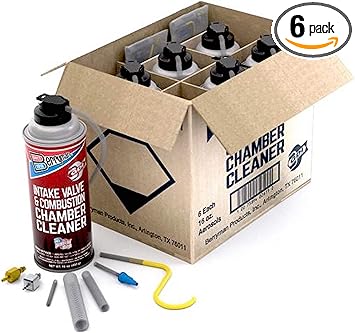

I have this sitting in the garage waiting. The Berryman stuff is also easier to use than the CRC. It can be done at idle and has a metering device which limits the flow of product along with a lock on the output valve dispersing the product.
