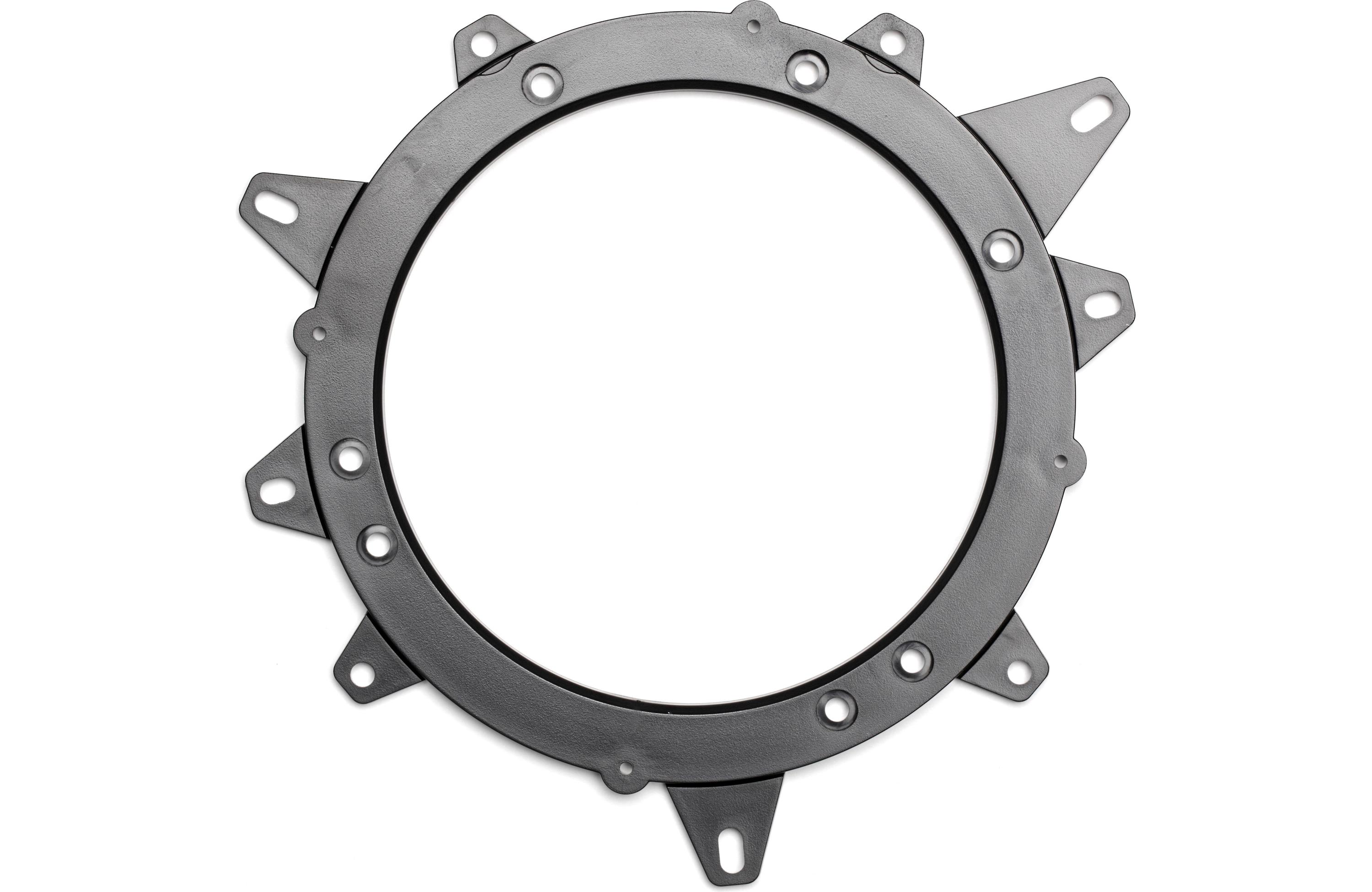

Hello again CRAZYHAWK. So I intalled the front speakers yesterday. The mounts from ebay you recommended were a life saver. Do you know if the same mounts are needed for rear doors? For some reason I ordered these for the rear doors: "1 PAIR UNIVERSAL 6.5" / 6.75" SPEAKER ADAPTER Angled SPACER MOUNTS RINGS". I'm not sure why but I must have read it in a different post.
The rear's aren't angled like the fronts... They basically fire straight at each other. Some people just used the 'universal' mounting ring included with most speakers as they fit with a bit of an 'adjustment' to the mounting holes on the ring (at least on my Polks). However, with the 'universal' mounting ring, the speaker ends up being a little bit further away from the door card than what the stock ones are so putting a 1/2" spacer ring between the mounting ring and the speaker works well.
Great. Thanks for the reply rlouie. I've got some mounting rings (image here) that came with the speakers (Polk db651). So between those and the ones I ordered off ebay, hopefully I'll have something that works.
And I guess if I use the angled ones, it won't hurt, given that the rears are coaxials, so the tweeters will be pointing more upwards towards the rear passengers.
It's not going to hurt because it's not going to fit. The space in the rear is small in comparison to the fronts. Sell off the second pair of angled brackets here as someone is going to need them shortly (they always do) and get some straight half inch spacers. Oh... BTW> Don't forget to fill in the ring cavity on those brackets with some household caulking so that it will reduce the vibration from the speaker and put some CLD on the sides of the bracket as well.
Ah, I see. Thanks for the clarification. Very helpful!! Right so half inch spacers. Could I ask you to take a look at these on Amazon (Xscorpion SP-DE65 Stackable 6-1/2-Inch Speaker 1/2-Inch Up Depth Extender) and let me know if you think they'll work? I have to get them ordered quick because I've got Saturday all scheduled for the install. Ugh.
They look the same as most spacers so they should be fine. Remember to take this opportunity to add some household caulking to the underside of the spacer (between the holes) so that it will be more rigid.
